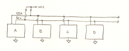

Topology
I2C uses just two wires: a data line called SDA and a clock line called SCL. Even as you add more devices to the bus, there are still only two wires.
Both I2C lines are open-drain and are pulled up with a resistor. To put a 1 on the wire, you change your output to high-z. To put a 0 on the wire, pull it low.

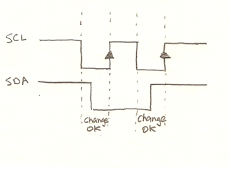

With synchronous serial in general (including SPI), the data line is allowed to change pretty much any time it can get away with it. I2C changes this, establishing that under normal circumstances, the data line may only change state when the clock is low.
During normal data transfer, the data line may only change when the clock is low.

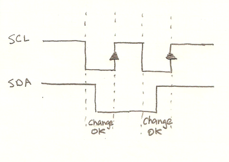

Writing a Bit on the Bus
As long as SDA (data) does not change when CLK (clock) is high, data can be sent on the bus. CLK will go low, SDA will change to a 1 or 0 if it needs to, and then the clock will go high. In I2C, a clock rising edge means that the data line is valid.
CLK then goes low again, and the process repeats. During the time that SCK is high, SDA should not change unless the master is trying to signal START or STOP.
Bits are written with the most significant bit first.

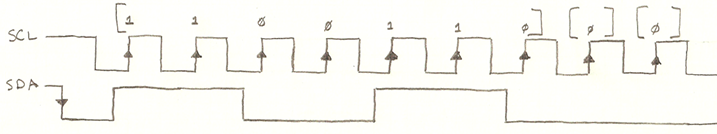

Address, Read/Write Bit
Next, the master writes out 7 address bits (most significant first, as with all I2C data).
The master pulls the clock line low, changes (if required) the data line, and brings the clock line high, writing the first bit. Then the clock line is pulled low again, and the process repeats.
The 8th bit is the direction bit. If this bit is a 0, it means this: Hey, device, I’m going to write some data to you. If it is a 1, it means this: Hey, device, please send me some data.

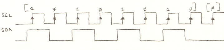

Data is sent one byte (8 bits) at a time, MSB first. If writing data to the device, the master controls both the data line and the clock line. If reading data from the device, the master controls just the clock line and lets the slave pull down the data line as it needs to.
Each byte sent or received is followed by a NAK (leaving the data line high) or ACK (pulling the data line low) by the slave. This acknowledgment bit is the 9th bit.
In the image above, we send (or receive) the 0b 10101010, followed by an acknowledge.
