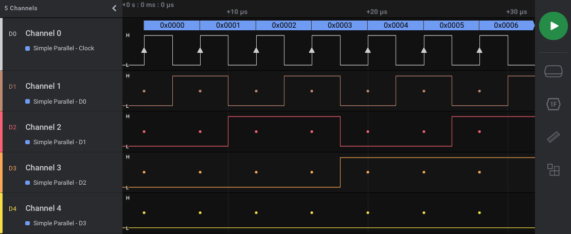

The Saleae Logic software includes a protocol decoder to read clocked (synchronous) parallel bus data. The analyzer supports between 1 and 16 bits of data bus, although realistically, only 15 bits are possible due to the relance of a clock signal taking up one channel. The example image below shows a 4-bit data bus and a clock signal, which requires 5 channels.

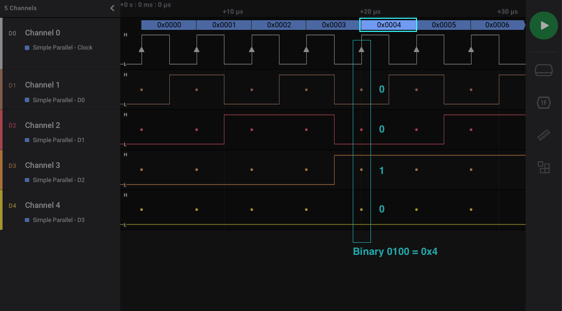

When using the Simple Parallel Analyzer, you will notice arrows and dots in the capture. You will also notice that the data is decoded above the Clock channel.
  • Arrows - These represent when the sampling of the data bus takes place. In the example image above, we have set the Simple Parallel analyzer to treat data as valid on rising edges.
  • Dots - The dots will be time-aligned with the arrows, and will give a representation of where data sampling takes place in the respective data bit channel.
An example is shown below for how a 4-bit data bus and a clock signal will be decoded using the Simple Parallel Analyzer. Note that the decoded data bubble (in this example, “0x0004”) will always appear as a 16-bit hex number (i.e. 0x0000), even when a smaller data bus is decoded (in the case below, a 4-bit data bus).
Decoding Parallel Data into Hex

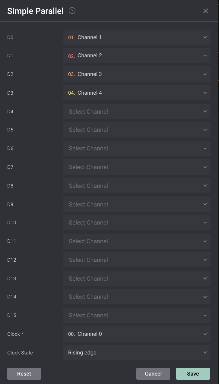

The settings for the parallel analyzer are described in this section. First, for all unused data bits, change the selected channel to “None”. For instance, if you’re using a 4-bit data bus, change D4-D15 to “None” in the settings as shown below.
Then, correctly assign the data bits you are using to the corresponding channels.
Finally, set the clock channel and the clock edge correctly and press Save.
